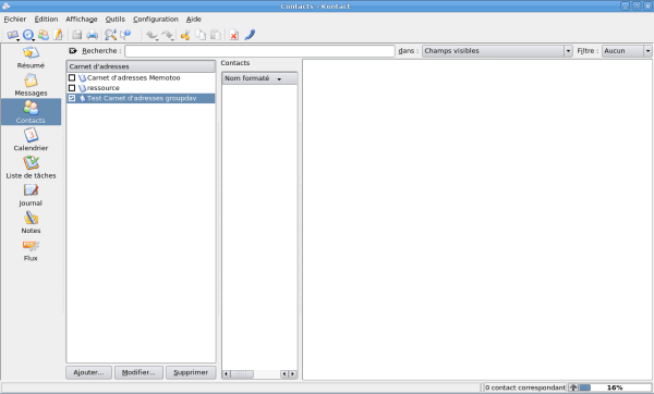

smile Posted 2008-02-06 - 14:24     Subject: Re: Re: groupdav issues using KDE Kontact with memotoo
The groups (using groupdav) now appeears but i see no contacts. The error message is "libkcal: ERROR: Can't read uid map file '/home/hsaly/.kde/share/apps/kabc/uidmaps/groupdav_eRqks5yFqB'"
Maybe a problem (as mentioned before) with missing vCard UID field or vCard 2.1 (kaddressbok is based on vCard 3.0 i think) issue.

smile Posted 2008-02-08 - 10:41     Subject: Re: groupdav issues using KDE Kontact with memotoo
Dear Hendrik,
I didn't react to your message because you perfectly described the situation and it's all the same for me. Following the recent changes of the webmaster, the different memotoo folders appeared but up to now my contact are not displayed.
For what concerns the network options, I undo automatic change to status new, as advised by the Kontact team, and it seems it doesn't work either. This trouble persists for you Hendrik ?

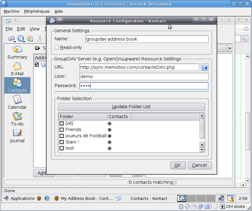

Skaldrom
smile Posted 2008-04-16 - 07:41     Subject: Re: Re: groupdav issues using KDE Kontact with memotoo
Same problem here. The new Version does not sync....
OS: eeeXubuntu
Kaddressbook: 3.5.6
I click on "Update Folders" and nothing happens... It did work in older versions.
Addition: It looks like it has todo with the GUI you use! It works for me in a kde environement, but not in GTK/XFCE...
smile Posted 2008-04-20 - 17:03     Subject: Re: groupdav issues using KDE Kontact with memotoo
I don't know why it didn't work with eeeXubuntu or others OS because I have just try with eeeXubuntu and it's OK for me, I can "Update Folders".
Have you idea what is the difference between my test and your OS ???

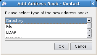

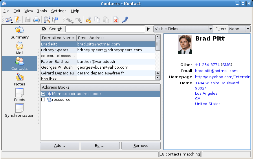

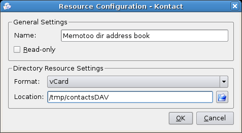

2 - Create a directory address book in Kontact
* Open Kontact
* Click "Add ..." and "Directory"
* Select your folder mounted
* Now you see all your contacts in Kontact
